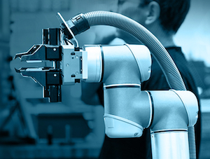

Universal Robots' arms are designed to automate and streamline repetitive or potentially unsafe tasks in businesses of all sizes.
