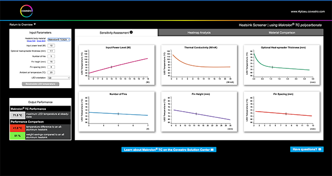

Heat sink screener
Covestro's online heat-sink screener smooths the transition from aluminum to polymer.
Covestro has also developed an online heat sink screener portal to assist engineers in making the switch from aluminum to plastics by entering design parameters such as thermal conductivity, input power level, and number of fins for an LED heat sink, also molded using X2F technology. “This screener has proved to be a valuable engagement tool and very helpful to get traction with initial customers,” says Paul Platte, Senior Marketing Manager, Mobility Automotive, at Covestro.
