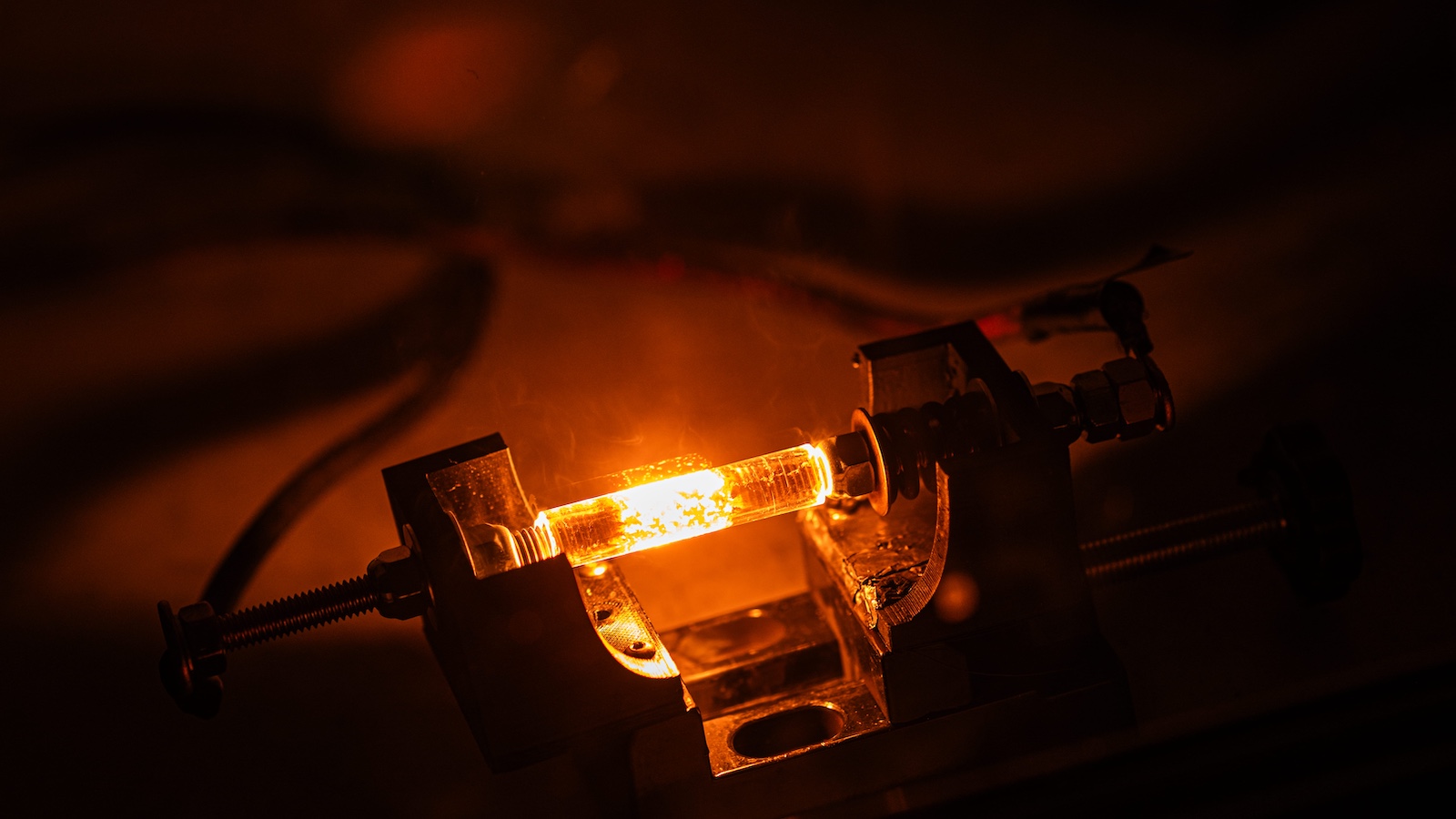

Tour’s lab has already made headlines for developing new waste disposal and recycling applications using flash Joule heating, a technique that passes a current through a moderately resistive material to quickly heat it to exceptionally high temperatures and transform it into other substances. Tour said when he learned of the issues involved with GFRP disposal from colleagues at the Defense Advanced Research Projects Agency, he thought that this kind of turbo-heating could transform GFRP into silicon carbide, widely used in semiconductors and sandpaper.
“We already knew that if we heat the mixture of metal chloride and carbon by flash Joule heating, we could get metal carbide — and in one demonstration, we made silicon carbide,” Tour said. “So, we were able to leverage that work to come up with a process to transform GFRP into silicon carbide.”
This new process grinds up GFRP into a mixture of plastic and carbon; more carbon is added, when necessary, to make the mixture conductive. The researchers then apply high voltage using two electrodes, bringing its temperature up to 1,600 to 2,900°C (2,912 to 5,252°F).
“That high temperature facilitates the transformation of the plastic and carbon into silicon carbide,” Tour explained. “We can make two different kinds of silicon carbide, which can be used for different applications. In fact, one of these types of silicon carbide shows superior capacity and rate performance as battery anode material.”
