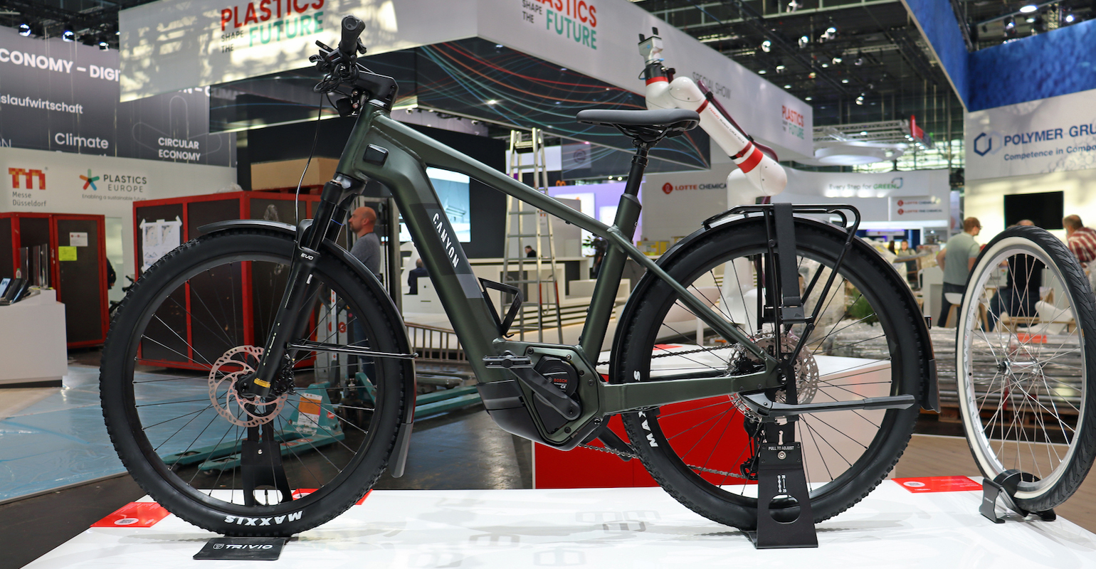

In one recent project, designer Didier Biron, founder of Biron-Etudes (Dornes, France), worked with DuPont to build an airless tire concept. Lopez and the team helped to select a specific Hytrel thermoplastic elastomer (TPE) grade (HYT6356) with Shore D hardness of 60 that would provide the correct levels of impact resistance, flex fatigue resistance, high and low temperature performance, and recyclability.
The design incorporates Hytrel flanks on which a rubber tread band is adhesively bonded. These flanks were devised as two half shells that could be mounted on standard rims.
Testing by Biron confirmed that the design and material combination could bear the load/stress and meet the max acceptable (vertical) deformation. Moreover, based on frontal curb impact tests, the airless tire offers excellent impact resistance.
Biron’s airless tire can significantly reduce maintenance time and cost because it isn’t vulnerable to punctures, and the two-part design enables swift replacement without removing anti-theft screws. The new airless tire efficiency is 80% that of a conventional tire due to higher rolling resistance. Because it is intended to be used for self-service bike fleets, lower efficiency is acceptable.
