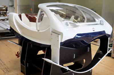

The SeaBubbles flying water tax employs materials such as bio-based epoxy resins in its structural components.
In addition to satisfying the composite engineering targets for weight and stiffness, Décision's manufacturing process was also required to include a significant percentage of bio-based materials. For material development, Sicomin made the perfect partner as the leading formulator and supplier of a wide range of bio-based epoxy resins, natural fibers and core materials.
All of the SeaBubbles composite parts are produced using a vacuum infusion process where the sandwich structure comprising of reinforcement fibers and a natural cork core are infused with Sicomin's GreenPoxy InfuGreen810 advanced resin system.
