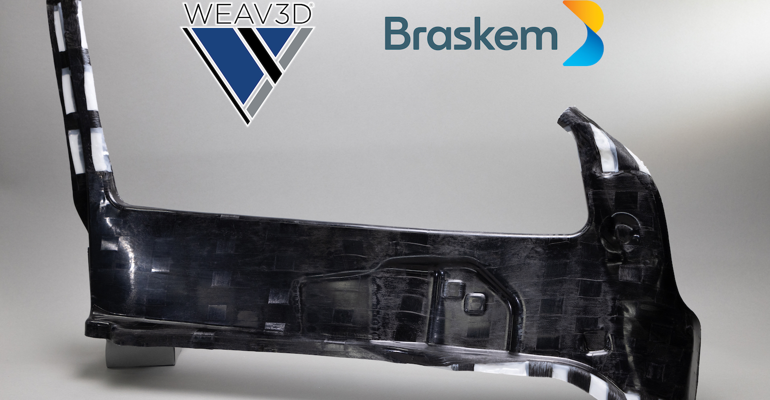

Image courtesy of Braskem
Polyolefins producer Braskem has unveiled a novel demonstrator part that combines Braskem’s polypropylene (PP) resin in combination with Rebar for Plastics reinforcing technology from WEAV3D Inc., an advanced manufacturing and materials startup. WEAV3D’s thermoplastic composite lattice technology is based on unidirectional, fiber-reinforced composite tapes and enhances the performance of PP for structural and automotive material applications.
The WEAV3D lattice technology enables lightweight PP parts to replace metal materials such as steel, increasing PP’s use in automotive applications by balancing improvements in performance, weight, and cost. The combination of Braskem PP sheets with WEAV3D’s Rebar for Plastics will allow Braskem to compete in new structural material end markets.
