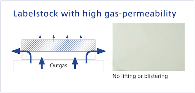

Conventional labels lift and blister due to outgassing from polymers (above), whereas a label stock boasting high permeability (below) does not suffer this fate. Images courtesy of Lintec Automotive.

Some suppliers of auto data labels have painstakingly designed adhesive carriers from incredibly fine-celled polymers. These “blister-free” films allow air to pass through without creating any visible holes in the surface. To the naked eye, the best examples look like any other smooth, airtight sticker. However, the difference is clear when you adhere the sticker to a surface with a pocket of air trapped in the middle, press on it, and the bubble just disappears.
How do they do it?  Well, there are actually several technologies at work. These composite pressure-sensitive films are formed by laminating a surface base with cellular film—often polyester. Any outgasses generated by the substrate (or air bubbles trapped during application), can then pass through the cellular structure film. Blisters and bubbles disappear quickly with a little pressure.
In addition, a special cavitated underlayer is designed with a clever lateral air-release mechanism: micro-channels formed on the adhesive surface allow air to escape out the sides of the label, keeping it flush with the surface as outgasses flow towards the edges.
