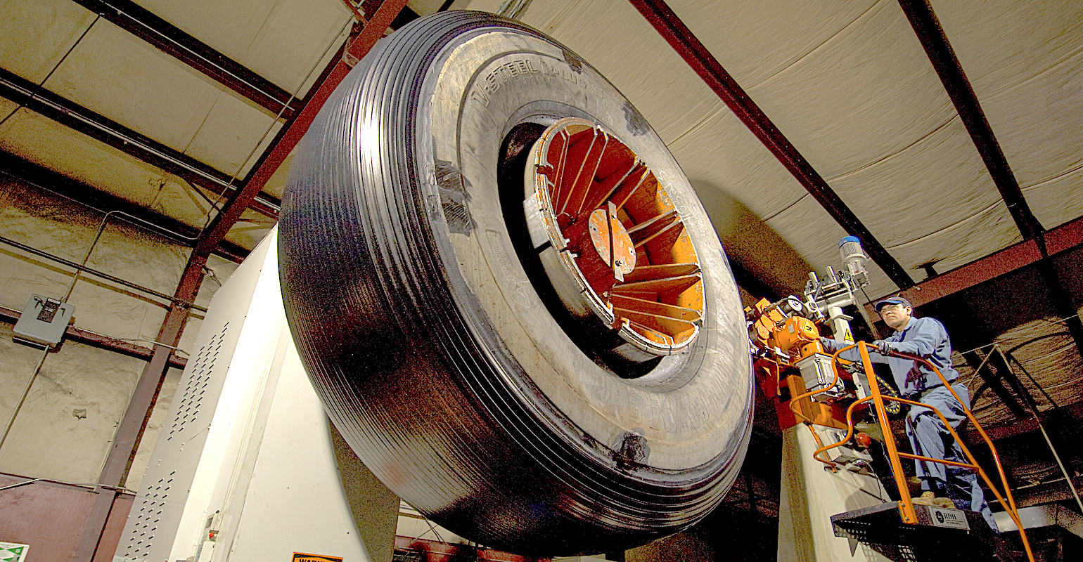

The team’s approach will be to use 3D scanning technologies, new materials that can both be printed and resist the solicitations of commercial vehicle tires, as well as industrial robots that can print these materials only at selected locations around the used tires.
While today’s process removes the entire tread of the old tire, the Virginia Tech process would only remove the bad portions, adding new material in those places. They 3D print the cushion rubber onto the tire surface in those places, providing the glue needed to attach the fresh tread.
The challenge is that the cushion rubber is a thick material that doesn’t flow well when it is printed onto the tire surface and it doesn’t cure quickly, so these were key areas targeted by the project, said Williams.
Tim Long, who recently moved from Virginia Tech to Arizona State, provides expertise in the polymers being tested, while Williams is responsible for developing the 3D printing process.
Because 3D printers generally print on flat surfaces and tires are circular, the Virginia Tech printer works its way around the target tire as it prints so that it can create a curved surface.
Now, at the mid-way point of the two-year project, the team has developed promising materials and techniques, so the coming year will involve employing them to produce actual tires and to test those tires to learn their characteristics. "Right now our material is showing the same performance of the traditional bonding rubber, so that is very exciting," Williams said. "We know we can 3D print it, so that is very exciting, and we have just finished building our robotic work cell with the scanning capabilities. So we’re ready for year two, where we put all those pieces together."
That means checking the real-world performance of these various components. "Now we look at how well our printer rubber attaches to the old rubber and make sure the whole ‘sandwich’ comes together," he continued. "The biggest test will be that we are sending some of our printed materials down to our partner, Michelin, and they’ll actually put them on a test track on a vehicle in the next year."
