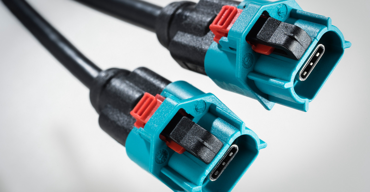

C-KLIC connector system
Image: BASF

German data cable company MD Elektronik has taken on these challenges and, with the help of engineering plastics supplier BASF, developed the C-KLIC connector system conforming to the USB Type-C standard. A glass fiber–reinforced polybutylene terephthalate (PBT) suitable for use in vehicles, Ultradur B 4300 G4 requires up to 60% less space than a standard USB port because of its material properties. Moreover, the device boasts a data-transfer rate >10GB/s and optional USB power delivery.

Due to the material properties, Ultradur is used in the connect+adapter (CPA) element, coding housing, and internal overmolding. The PBT grade displays its full strength especially in the internal component. Further, thanks to its electrical properties and dimensional stability, the engineering plastic protects the sensitive electronics from external influences such as humidity and dirt. Compared to a standard USB charging module with integrated electronics, the new connector system can be produced in much smaller dimensions, which saves installation space and weight.
