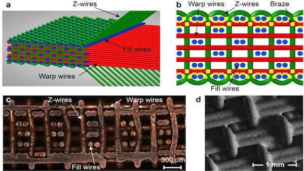

In the diagram below, (a) shows a 3D woven (3DW) lattice material composed of Z- (green), warp (red) and fill (blue) wires; in (b) the yellow color indicates the brazing locations (at the top and bottom)¥; in (c) the cross-section of a 3D woven lattice with a stiff skeleton (the brazed portion on the top and bottom) and free lattice members in the core of the structure is indicated;  (d) shows an SEM image of the brazed top face, which confirmed metallurgical bonding of the metallic lattices.
