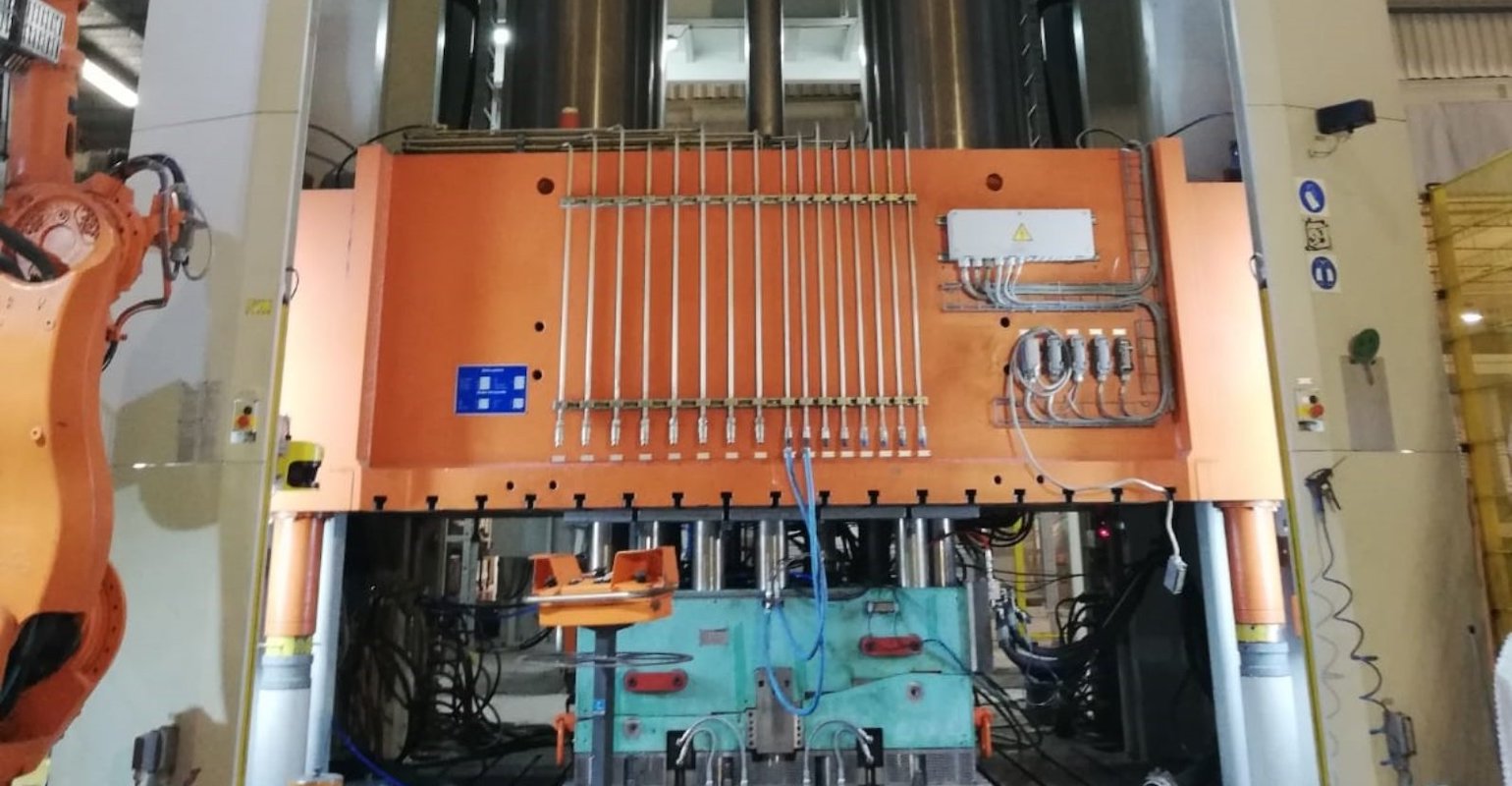

To support several carbon fiber RTM programs that will begin as soon as the end of 2020, CSP and parent company Teijin are investing in a dedicated CF-RTM production line in Palmela, Portugal. The initial investment of €5.5 million will include the installation of compression presses, RTM injection units and a bonding cell.
“We are excited to be working hand-in-hand with our customers in Europe to demonstrate our RTM capabilities,” said Ricardo Barros, CSP/Inapal program manager. “The level of industrialization and automation we are installing in Palmela is second to none for similar carbon fiber applications.”
