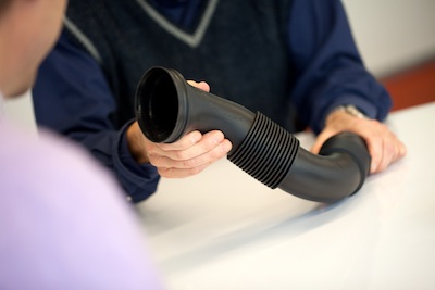

DSM adds to its blow molding grade selection for auto applications. [Photo: DSM]
The Akulon Diablo PA66 GF25 and Akulon Diablo PA66 GF20 grades both leverage exclusive DSM technology to maintain tensile strength despite rigorous heat-aging tests exceeding 200°C for 3,000 hours. The unique formulation allows the material to attain high initial strength and to retain that strength with prolonged exposure to heat.
This inherent strength allows for thinner-walled part design, which can reduce total system mass by up to 40 percent. The material has also been designed to offer robust heat aging performance at both extreme as well as more moderate temperatures. This helps to ensure that the product performs over a wide range of performance conditions in order to cover a broad array of application needs.
