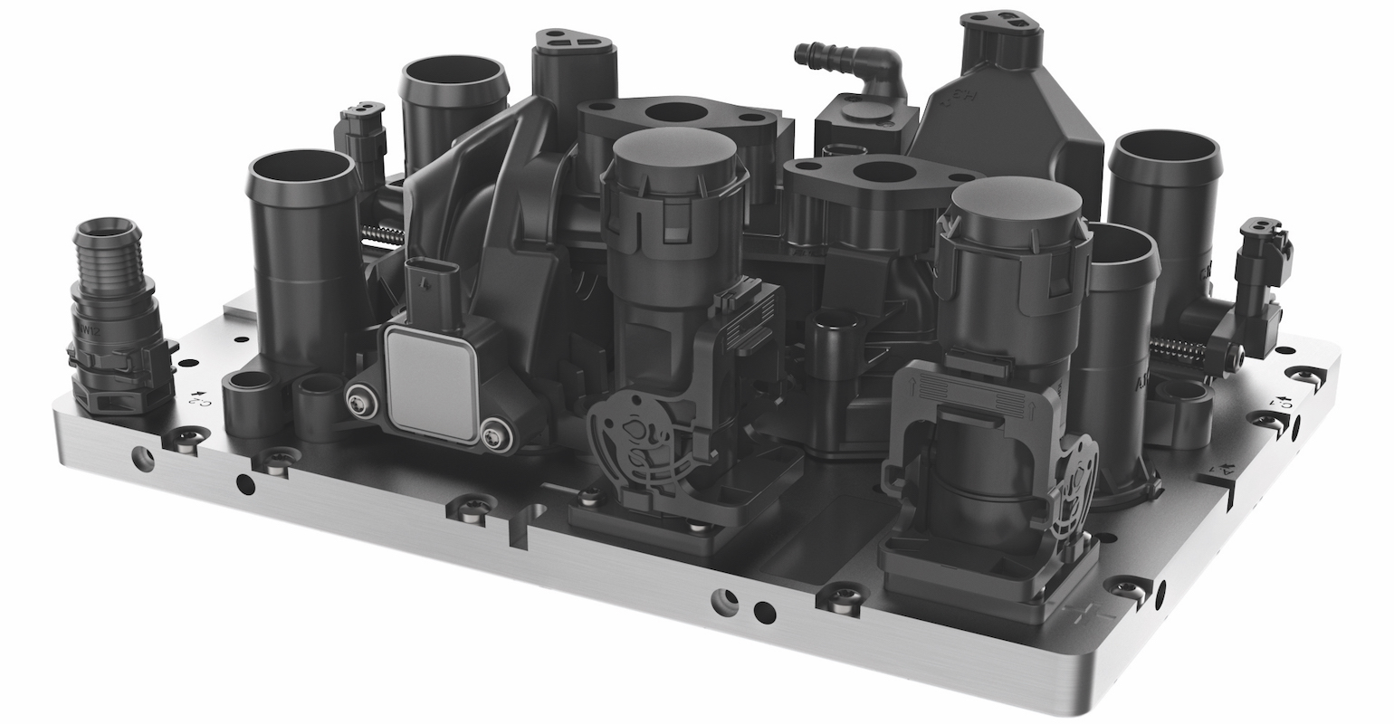

The NM5-EVO is a platform intended for use on different types and models of vehicles. Its design includes standardized automotive fluid and media connections, an anode loop with integrated water separator, purge and drain valves, as well as other necessary connections and sensors, all packed into a housing. Besides the media supply, a cell voltage measurement unit is integrated, mounted with components molded with DuPont Crastin PBT. The need for safe and reliable operation under various conditions (including freeze start of -30°C) and lifetime requirements challenged the team.
Enormous demands placed on plastic parts
Each cell in the stack needs to function independently, and this places enormous demands on the thermoplastics selected for the many components of the media supply. These polymer parts must perform under aggressive conditions, with different fluids, in a very small space. EKPO had experience manufacturing these components using various thermoplastic materials but was seeking a material that offered greater processability.
To support the engineering team at EKPO, DuPont fine-tuned an established grade from its range of Zytel HTN EF electrically-friendly materials to meet the special demands of fuel cell components. The new grade was optimized to enable extremely efficient molding and laser welding. Together, these supported the customer’s goals for efficient production and also enabled the compact, complex design.
Importantly, the solution also offers extremely high levels of purity, which is critical to ensure there is no reaction with the fuel-cell medium or poisoning of the cells. The high CTI value of this special DuPont solution gave it a significant advantage over the previously used material.
Further, the Zytel material’s dwell time and resistance to flash buildup helped EKPO optimize injection molding machine efficiency. Dimensional stability and the resistance to aggressive fluids and internal pressure up to 2.5 barA (absolute) ensured components molded from the material would remain safely leakproof through the long, useful life of these fuel-cell stacks.
Components manufactured from DuPont Zytel HTN EF include media modules, cathode end plates, anode endplates, and gasket carriers. In addition, the cell voltage measurement side covers are molded from Crastin PBT.
