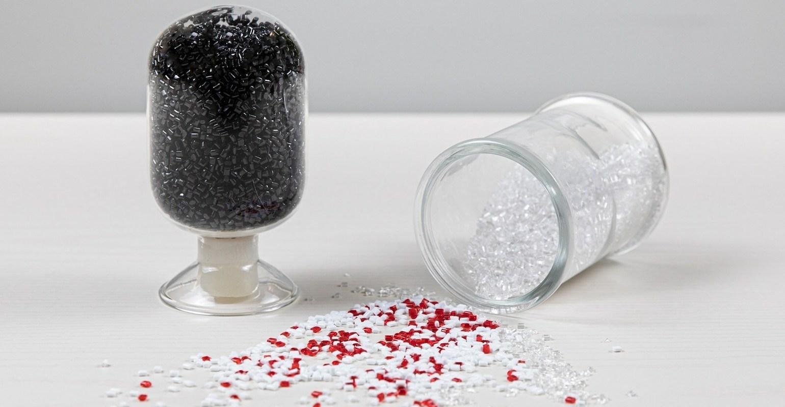

recycled and virgin polycarbonate pellets
Image courtesy of Samyang Corp.
Samyang Corp. has developed Korea's first eco-friendly polycarbonate (PC) resin containing more than 90% post-consumer recycled (PCR) material. Transparent and resistant to impact and heat, PC is mainly used in interior and exterior components for automobiles, home appliances, soundproof walls, and medical device parts. The new grade is UL-rated at V-0.
