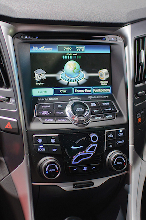

Paterson explained that there is a push toward creating innovative ways to interface all the various electronic systems and incorporate touch screens. The fact that the touch screen, which contains the menu for the various operations, is flat is a design and aesthetic concern for some stylists, Paterson noted. Many consumers prefer conventional knobs because they don’t want to have to search for the menu on the touch screen.
“Customers are looking for innovative ways to house the touch screen and give it a more organic appearance,” said Paterson. “There are certain functions in the vehicle that will never be relegated to the touch screen because consumers don’t want to be searching for the menu to adjust the volume, for example. The other function is the horn. Things like that will always be standalone buttons, and the touch screens themselves will be embedded in the instrument panel.”
Minimalism is an objective embraced by product designers to make the interior less threatening. ADS addresses this by harnessing its backlit technology, which allows the control functions to only appear when the driver needs them.
