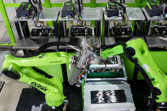

The integrated production cell produces custom thermoplastic blanks in cycle times ranging from one to three minutes. Image courtesy Engel.
Tailor-made composite blanks help leverage the lightweight design potential of parts, said Engel in a press release announcing the award. To efficiently make semi-finished products from both glass- and carbon-fiber-reinforced tapes with a thermoplastic matrix, the Austrian injection molding machine manufacturer combined a tape-laying cell with a consolidation unit in a highly automated production line. The integrated process can produce fit-for-purpose blanks with 15 to 30 tapes in one-minute intervals. The throughput and efficiency of the process led the international jury to reward Engel and Fill in the process category of the competition.
To minimize cycle times, individual tape layers are picked up, visually checked, placed with closed-loop control, and spot-welded together in the cell. Since the quality of the resulting stack depends on the accuracy of tape positioning, Engel equipped the laying cell with a measuring system that uses high-resolution camera technology and two high-speed robots.
