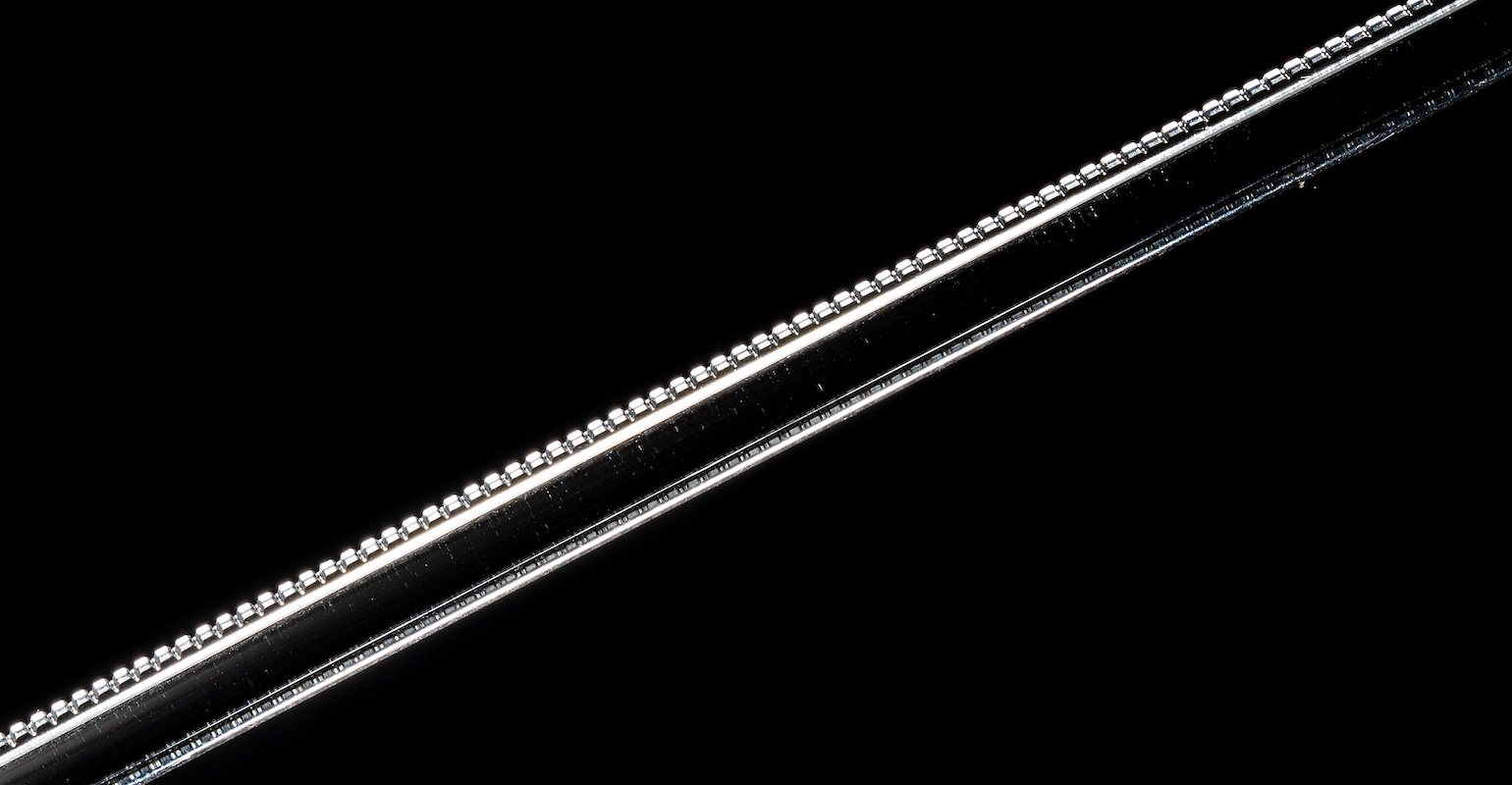

LEDs are becoming increasingly versatile in vehicles, and now are often added as distinctive design elements. The level of variation in their shape is growing accordingly, creating new challenges for optical-fiber manufacturers. Engel has developed a new plasticizing process specifically for acrylic resin processing to ensure luminous efficiency, also for use cases involving complex geometries and long structures. The principle of starve-feeding is decisive from a technological standpoint. It allows the plasticizing screw to be only partially filled with pellets in the intake zone, which, in turn, reduces the shear load of the melt. In this way, melt homogeneity and purity can be improved.
Engel is demonstrating the huge potential of the new processing technology by producing light guides of different lengths and curvatures in a family mold by Oerlikon hrsflow on an Engel victory 320/120 injection molding machine with an integrated Engel viper 20 linear robot. Thanks to tie-bar-less technology, the large family mold fits on a relatively small injection molding machine. The robot can reach the cavities directly from the side without needing to work around interfering edges, which shortens handling time.
