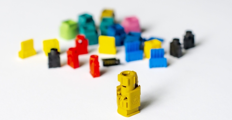

One real eye-catcher on Envalior’s stand will be the colorful range of Fakra connectors made from ForTii Ace polyphthalamide (PA 4T PPA) compounds for applications such as navigation systems, antennas, and advanced driver assistance system sensors. These PPA compounds combine the low moisture absorption and color and dimensional stability characteristic of polyesters with the high-quality mechanical properties and unlimited dyeing capability of polyamides.
The compounds exhibit long-term thermal stability up to 180°C as well as exceptional tracking resistance and dielectric strength. “As far as we know, these are the only polyamides in the world that fulfill the JEDEC MSL1 standard. This means that the compounds and the components made from them can be stored for an unlimited time without the need for any specific packaging to protect them against moisture,” said Sidiki. The product range also includes halogen-free, flame-retardant variants and materials that inhibit electrical corrosion on metal contacts.
