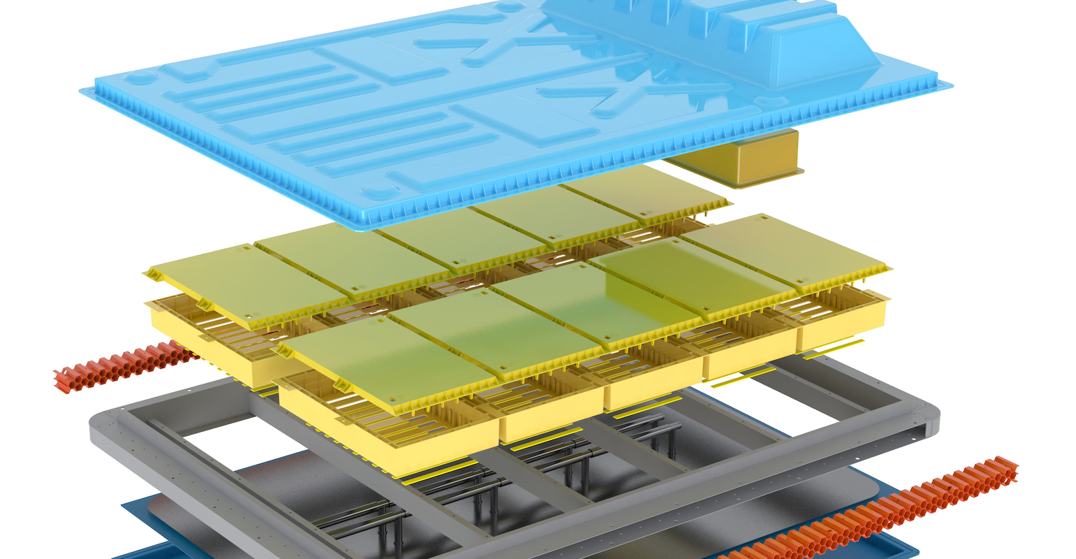

As automakers accelerate their shift to an all-electric future, Sabic continues to develop thermoplastic-based solutions and harness its expertise to help industry optimize the performance of electric vehicles (EVs). Most notably, the company’s automotive business has developed a plastic-intensive EV battery pack concept using a systems-engineering approach. The concept underscores the value of lightweight plastics to address critical industry needs for flexible design, enhanced performance, greater safety, and improved economics.
Compared with conventional battery pack designs using traditional materials such as aluminum and other metals, lightweight thermoplastics potentially can realize 30 to 50% weight savings per component, improve energy density, simplify the assembly process, reduce costs, and improve thermal control and safety.
“Our work on vehicle electrification technologies extends beyond simply pairing materials to individual components within existing designs,” said Abdullah Al-Otaibi, General Manager, ETP & Market Solutions, Sabic. “Our teams of experts take the complete EV battery system and vehicle structure into account so we can properly assist and enable our automotive customers to achieve their most critical vehicle development objectives.”
EV battery pack concept leverages properties and strength of thermoplastics
The Sabic-developed battery pack concept leverages the properties and strength of thermoplastics to improve performance, reduce cost and weight, and support mass production. Highlights include:
  • Integration of individual batteries into pouch cells placed within a thin-walled housing molded with a 30% glass-fiber-filled, flame-retardant (FR) polypropylene (PP) compound.
  • Geometric features, such as a double-wall construction, a novel rib pattern, and creative functional integration, all enabled by Sabic thermoplastics to reduce weight and meet structural requirements.
  • Creative use of the anisotropic thermal conductivity of plastics to optimize thermal management performance.
  • Integrated plastic-metal hybrid structures with Stamax FR long-glass-fiber PP material for the battery tray to optimize thermal transfer, meet drop test requirements, and absorb the significant impact energy that side frame members can experience.
  • A battery pack enclosure or cover molded with Stamax FR resin. Use of this material meets the UL94 V-0 flammability rating and allows the cover to be metallized for electromagnetic interference (EMI) and radio frequency interference (RFI) shielding.
  • Parts reduction and assembly efficiency, resulting in cost savings, enabled through the inherent design freedom of thermoplastics.
