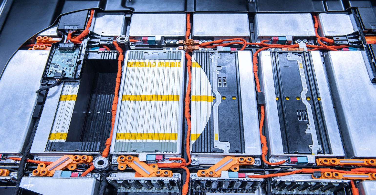

One of the growing applications for composites seems to be in the design and manufacture of EV battery enclosures. The very nature of such energy storage containers favors materials that have specific fire, thermal and electrical requirements for which composites are well suited. Further, the anisotropic behavior of composites when weaved together can provide torsional strength to the overall enclosure.
Even the shape of an enclosure can be more easily tailored to specific needs with the use of composites. A case in point is fiber-reinforced composite materials in which complex shapes can be created and strengthened with a careful layer of the material. This approach is opening opportunities for designers to create new and different enclosure shapes.
