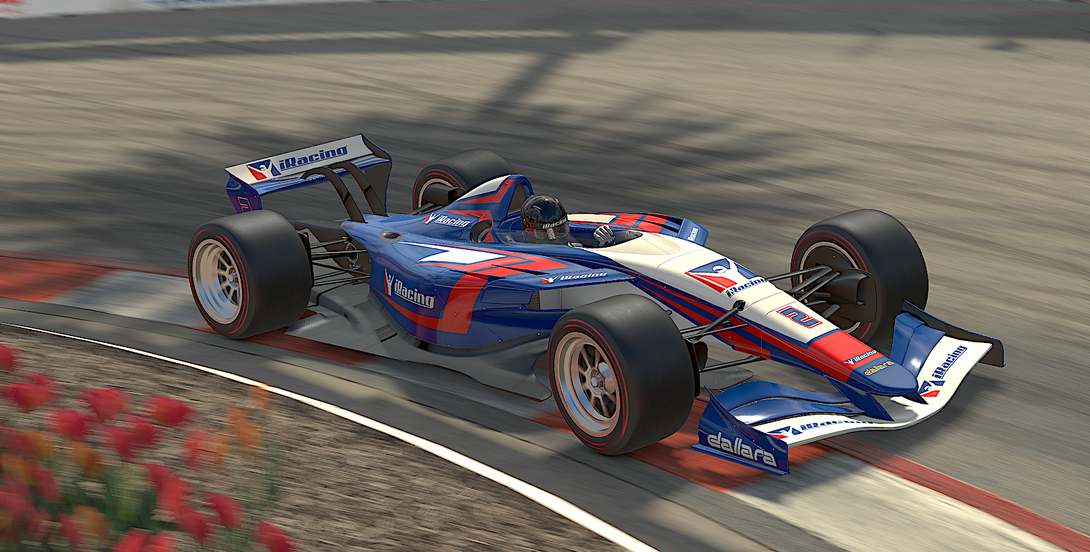

Andrea Toso: The idea was how to create an exciting car with a futuristic retro flavor. In a simple car, you don’t see many aerodynamic bodywork add-ons. It is clean, simple.
Because number one, not too much aerodynamics. With aero, you go faster in the corners slower on the straits, and the shorter the braking distance. You end up with bad racing.
The second factor was the tires. We used 18-inch tires. Big tires. Their relative size is much wider than Formula One tires. The bigger tires make the driver challenged to go faster.
The third factor is visibility. As a virtual car, we can go away from the Halo. You still want a proper cockpit size. It is the driver’s office.
The car has simple electronics. There is no Drag Reduction System, active differential, or traction control. It takes maybe 10 laps to learn this car.
