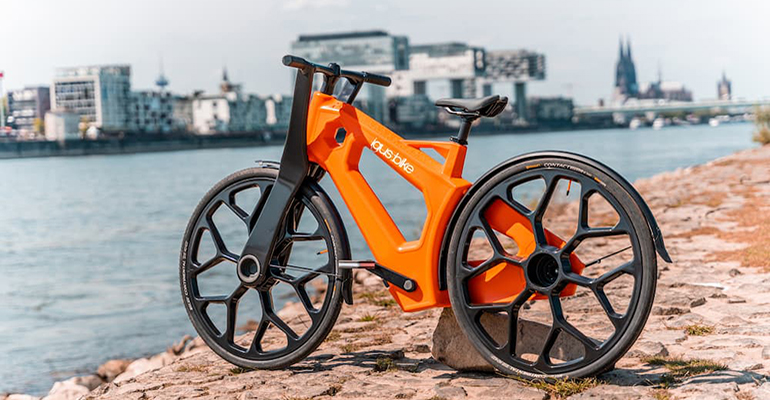

Granted, you won’t see it in the Tour de France, but for tooling around town, this bike is a winner. For one thing, the igus:bike won’t rust. “As all components are made of plastic, no part of the bike rusts, even the gears,” said igus CEO Frank Blase. You can leave the bike outdoors in any kind of weather and clean it within seconds using a garden hose.
Lightweight, lubrication-free high-performance plastics are used in all parts of the bicycle, from two-component ball bearings in the wheel bearings to plain bearings in the seat post, brake levers, and pedals, said igus. All of the components have integrated solid lubricants and ensure low-friction dry operation, without a single drop of lubricating oil. This ensures that sand, dust, and dirt cannot accumulate and gum up working parts, said igus. Coincidentally, this was the initial impetus for creating an all-plastic bike.
As the story goes, igus CEO Blase first had the idea for an igus:bike while vacationing at a beachside resort. Chatting with the folks who ran a bike rental shop on the beach, he learned of the major problems with beach bikes — continuous exposure to sand, wind, and salt water was brutal on parts, some of which lasted only about three months before they needed to be replaced. Constant maintenance and repair work could be eliminated, thought Blase, if the bikes were entirely made of plastic.
In addition to durability, the igus:bike also strikes a blow for circularity. A recycled version made entirely from waste single-use plastics was displayed at Hannover Fair in Germany. The initial prototype was made of plastic reclaimed from old fishing nets.
The bike is designed to be assembled and supplied by approved partners, and igus has made the engineering design and all key components available to bicycle manufacturers via the igus:bike platform. Dutch startup MTRL is working closely with igus and plans to have adult and children’s models on the market by the end of this year. An e-bike is also in the works.
The adult bike will retail for about €1,200 ($1,284); the version made with recycled plastics will have a surcharge of around €200 ($214).
