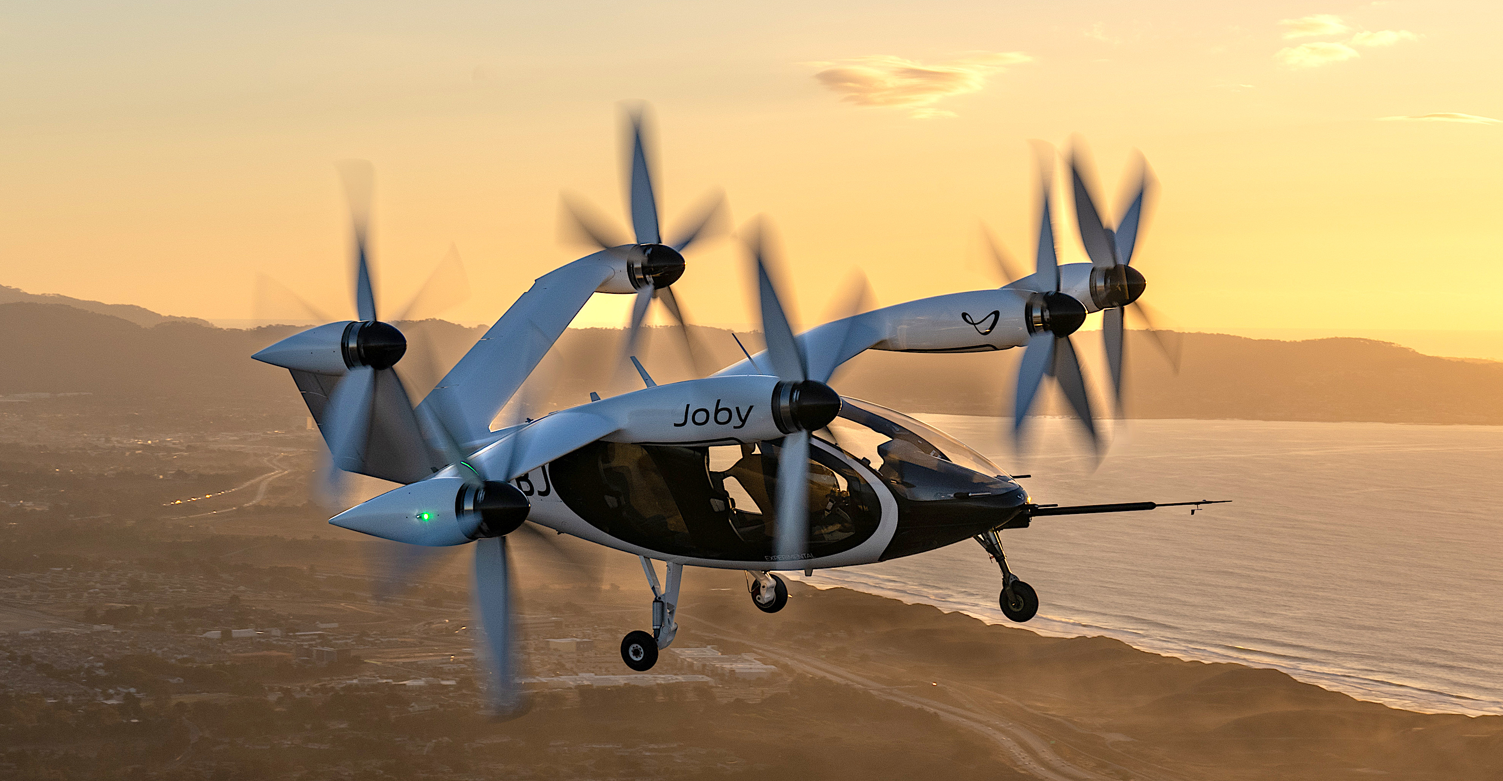

Joby Aviation's eVTOL aircraft in cruise mode.Joby Aviation
Joby Aviation has received a Federal Aviation Administration Special Airworthiness Certificate for the first aircraft built at its pilot production line in Marina, California, allowing Joby to begin flight testing of its first production prototype.

Joby’s aircraft has a payload of 1,000 lbs., which is expected to be sufficient for four passengers and a pilot. It will carry them as far as 100 miles at speeds as high as 200 mph. It can fly to and over populated areas because its sound level while cruising is a modest 45 decibels.
