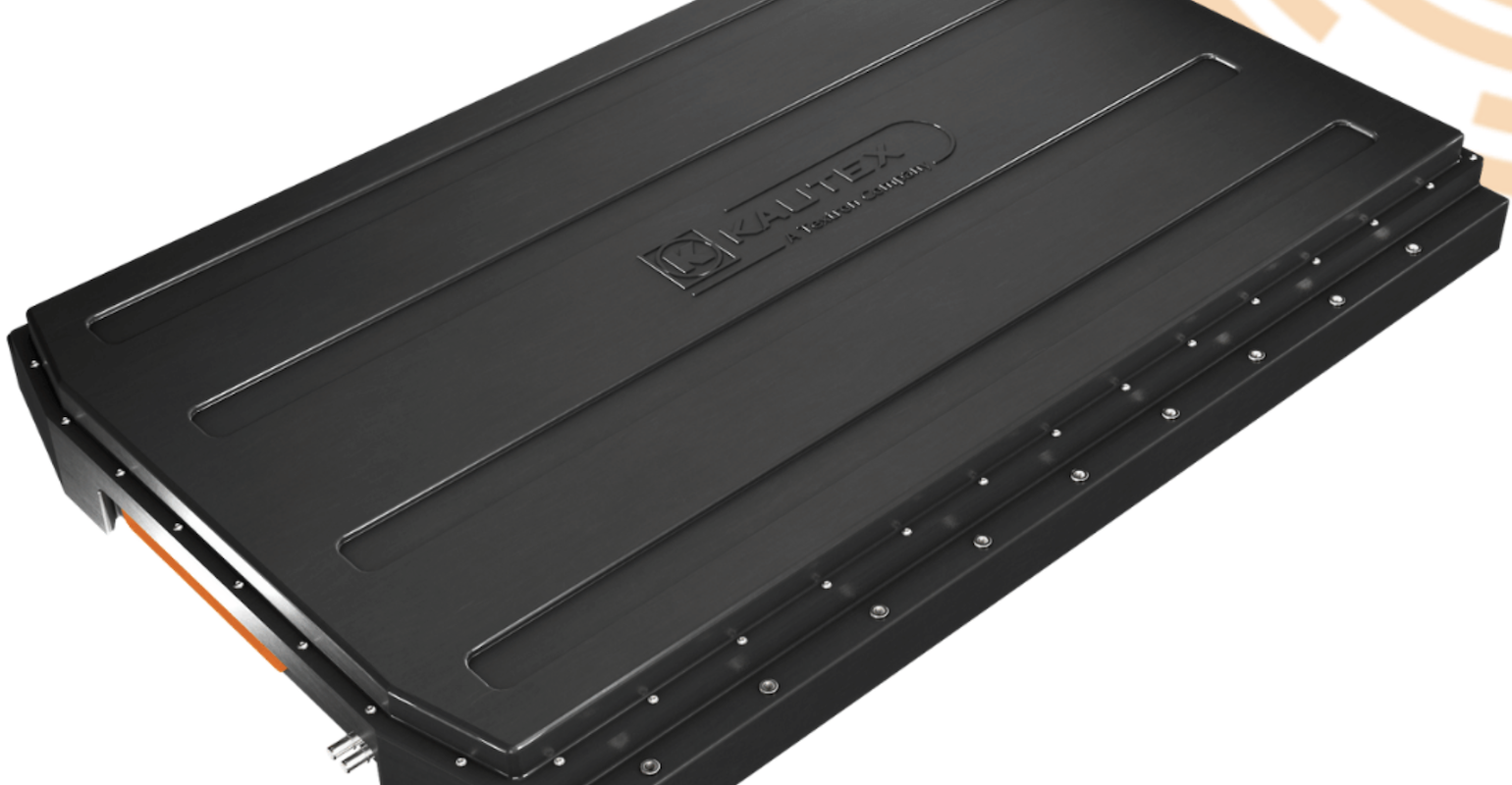

Kautex Textron GmbH & Co. KG plans to expand production capabilities at its plant in Pinghu, China, with the recent purchase of a direct-long-fiber thermoplastic molding line including a 5,500-tonne press. The line will produce Kautex’s latest automotive innovation, the Pentatonic battery system.
Pentatonic is a lightweight, customizable battery system for hybrid and full-electric vehicles. Manufactured from thermoplastic composites or composite-metal hybrid materials, it weighs up to 50% less than its steel and aluminum counterparts.
The one-shot production process enables structural and thermal management components to be integrated directly into the plastic shell, simplifying the bill of material and reducing the need for additional manufacturing steps. Fewer secondary operations, such as welding and riveting, are required, resulting in shorter cycle times than steel and aluminum systems while offering better leak-tightness.
