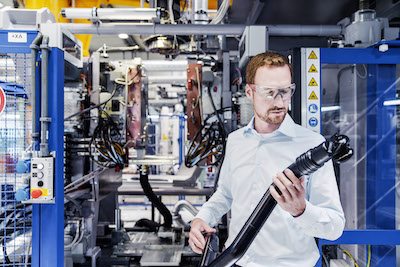

A KBS20-SB extrusion blow-molding machine from Kautex is at the core of Lanxess’ efforts to expand the role of polyamide in technical parts.
These trends motivated the High Performance Materials (HPM) business unit at Lanxess not only to set up a global team tasked with developing blow-molding materials and their applications in modern powertrains but also commissioning a state-of-the-art blow-molding system at the technical center in Dormagen. “Having our own processing equipment ensures that our blow-molding product types possess excellent processing properties,” said Dr. Klaus Küsters, who is responsible for developing the blow-molding business field at HPM. “Our customers benefit directly from in-depth processing expertise. The new system will also allow us to offer targeted assistance, for example during troubleshooting or at the start of series production.”
The new system is a KBS20-SB extrusion blow-molding machine from Kautex Maschinenbau GmbH. This new system means that Lanxess now also has two tools for manufacturing close-to-production components in the focus application fields. One tool is designed especially for air ducts such as charge air ducts or clean air ducts in combustion engines. Within a suction blow-molding process it can be used to manufacture complex pipes with varying diameters and oval cross-sections up to 630 millimeters in length. Clean air ducts with integrated bellows can also be manufactured. The second tool is designed mainly for blow-molded liners for high-pressure tanks in hydrogen- and natural-gas-powered vehicles. It also features a flat cavity area from which test specimens for calculating material characteristic values can be generated. “The resulting process-related material data give a very precise and representative material description and help our customers in application development,” said Küsters.
