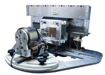

The new grades underwent stick-slip tests at several premium automotive OEMs according to the VDA230-206 standard using testing machines from Ziegler Instruments, with very positive test results: a 10-point scale is used where 10 is the highest risk level. The new Elix grades managed to
score 1 – the lowest risk level. Tests were conducted with different forces (10 N, 40 N) and speeds (1 mm/s and 4 mm/s) at several temperatures.
