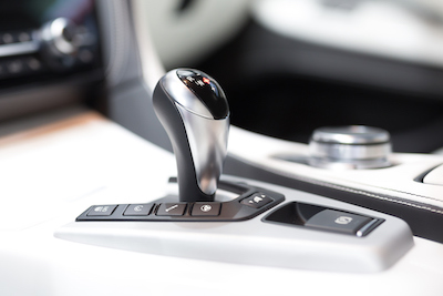

Easily transition from paint to metallic-effect with Smartbatch FX masterbatch. Image courtesy of PolyOne. |
