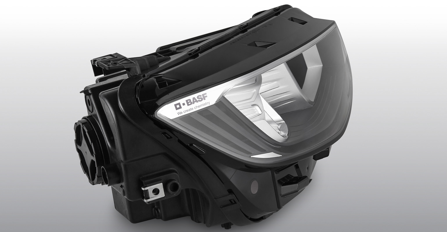

Image: BASF
BASF has introduced a new grade of Ultradur polybutylene terephthalate (PBT), which enables more attractive branding on metallic lamp bezel surfaces of automotive headlamps. The new grade was developed to meet growing demand from OEMs for improved branding opportunities on headlamps.
While Ultradur is already widely used for headlamp components such as lamp bezels and brackets, the new laser transmittance PBT unreinforced grade Ultradur 4570 HGL LT enables laser engraving on metallic lamp bezel surfaces. This provides clearer, high-quality logo markings on automotive headlamps.
In particular, the new grade helps customers avoid degradation on black lamp bezel surfaces during the laser marking process. The easy-to-process material features a glossy surface finish as well as low fogging and mold deposit.
