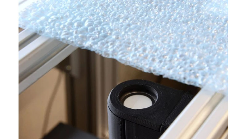

ultrasonic transducer inspecting plastic foam
Ultrasonic transducer inspecting extruded plastic foam.Image courtesy of SKZ Plastics Center

The measurement technology employs innovative air-ultrasonic transducers to record specific measurement data. This data is then correlated with relevant foam parameters. Further, an artificial intelligence–driven neural network, is created, trained, and optimized for this purpose. This enables reliable and reproducible in-line process monitoring.
“We are correlating a number of ultrasonic signals attributable to the bulk density and the cell size of the foams,” said Pierre Pfeffer, senior scientist in the field of non-destructive testing at SKZ Plastics Center. “Our previous research with terahertz and microwave radiation also proved quite reliable for the surveillance of foam parameters during production.”
