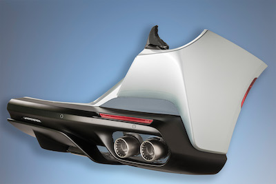

In a joint project, BASF and STR Automotive have brought components for premium vehicles into serial production for the first time using the new material Elastolit R 8819 Lightweight polyurethane (PU) system. In comparison to conventional processing with PU-RRIM (reinforced reaction injection molding) materials, the new process convinces due to significant weight reduction. The usual component thickness of 3.0 mm can be reduced to less than 2.5 mm, without detrimental effects on processing, quality or mechanical properties.
The front and rear bumpers of low-volume production cars are usually produced from polyurethane systems with short-fiber reinforcement, with a wall thickness of 3.0 mm. Attempts to lower the weight by reducing the component thickness or using a special filler combination and an associated lower material density failed due to insufficient mechanical properties such as  mechanical strength, stiffness and impact strength. This process also could not pass the climate change test.
In an intensive exchange between BASF and STR Automotive, a technological solution to the problem has been found, which is based on a high modulus PU basic material with high temperature resistance, stiffness and very good impact strength.
“The improved performance of the matrix material allows the designer to create a noticeably thinner component, without having to accept limitations in quality,” explains Jürgen Schneider from Technical Development at BASF Polyurethanes GmbH in Lemförde. Depending on the requirements and the application, Elastolit R 8819 Lightweight can be combined with different filler materials: a mineral standard fiber for components like rear bumpers, a mineral/carbon fiber combination for vertical components with low thermal expansion coefficient (e.g., side panels) or a combination of carbon fibers and light hollow glass spheres for components for which a particularly high weight reduction is a priority.
 “A decisive factor for the successful market launch of this new development was the close cooperation with STR Automotive. With this innovative specialist, we have a partner who supports material development at an early stage in existing components and has brought his expertise from component construction and manufacturing,” explains Giuseppe Monaco, Key Account Manager in the Performance Materials department at BASF Italia S.p.A.
In the first serial components made using Elastolit R 8819 Lightweight, the weight has already been reduced by 600 grams per m² surface area. For rear panels, this means a weight reduction of up to 1.5 kg. Dr. Massimo Cecchini, CEO of STR Automotive, says: “With the new material and the compatible filler options, we have a good set of tools enabling us to satisfy different requirements. For our customers it is important that they get high-quality components. Weight reduction must not be at the expense of quality and there must be balanced price-performance ratio.”
The Italian specialist in trim parts for automotive exteriors and interiors also sees potential for applications arising from the higher temperature stability of the material. This creates additional areas of application for the material, for example in the engine compartment.
