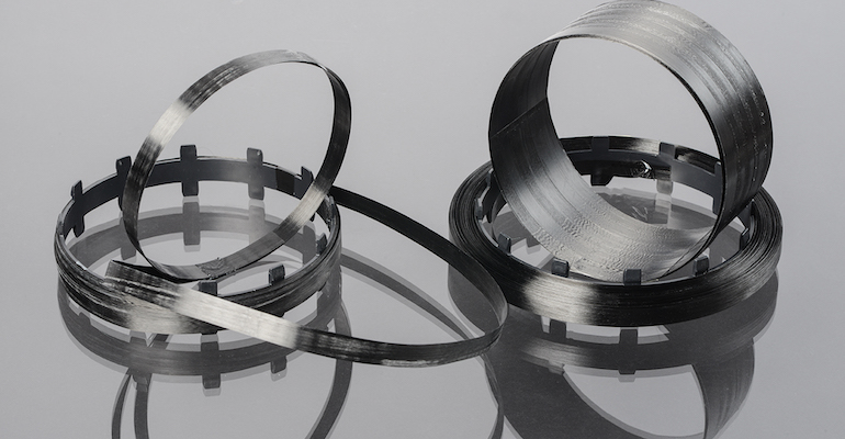

Recycled thermoplastic carbon-fiber-reinforced unidirectional tape.Image courtesy of Fraunhofer IPT

Pressure tanks are manufactured in a laser-assisted tape winding process: Thermoplastic glass- or carbon-fiber-reinforced tape is wound over a base body made of plastic, the so-called liner. The unidirectional (UD) tape that covers the pressure tank cannot be reused in the conventional life cycle of the pressure tank and ends up in hazardous waste dumps.
The recycling process patented by Fraunhofer IPT, which it continued to develop in the Tankcycling project, makes it possible to remove the UD tape from the liner in a peeling process. In this way, the tape can be reused with other products that are also manufactured using the tape winding process. Fraunhofer IPT researchers have developed a plant prototype with various modules: The tape passes through one module in the recycling process before it is stored on a spool at the end in another.
Tests confirm reusability
In downstream tests, the scientists compared the mechanical load-bearing capacity of the recycled material with the original material. They were able to show that the recycling process did not significantly reduce the quality of the material. Destructive standard tests demonstrated that the recycled material had lost only 5 to 10% of its mechanical quality compared with the virgin material.
Based on these findings, the researchers were able to define requirements for the recycling process and develop a tank recycling module. This module represents a further development of the recycling process, which was developed on a stationary test rig. In its miniaturized format, the tank recycling module can be attached to a robotic arm. This innovation allows pressure tanks with their complex three-dimensional geometry to be fully recycled. In addition, the recycling process and subsequent rewinding of the tape can be automated in this setup.
