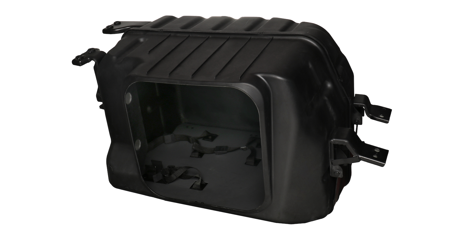

Sabic has collaborated with leading Chinese truck maker Dongfeng Motors to develop a novel plastic composite hybrid solution to produce a strong, lightweight truck-mounted toolbox. The application is made with a combination of Sabic’s Stamax resin, a long-glass-fiber polypropylene (PP), and continuous glass-fiber composite laminate inserts via a single overmolding process. The finished part is up to 30% lighter compared with a similarly designed steel part, and use of the solution allows Dongfeng to benefit from resulting production efficiencies.
Sabic’s hybrid solution combines Stamax resin with thermoformed composite inserts made of unidirectional (UD) glass-fiber-reinforced PP tape from China-based Qiyi Tech, a company focused on continuous-fiber-reinforced thermoplastic composite materials.
The laminate inserts are pre-heated before being placed in the tool and overmolded with Stamax resin in a single operation. The inserts add stiffness and strength to critical areas of the part, enabling the use of thin-wall geometries that can reduce weight.
The truck-mounted composite toolbox is up to 30% lighter compared with a similarly designed part in steel. |
Compared to steel, the conventional material for truck toolbox applications, Sabic’s plastic composite hybrid product expands design options, enables the consolidation of parts, and avoids secondary operations that can add cost and prevent high-volume production.
The plastic composite reduces the weight of the toolbox from 6 to 4 kg without sacrificing the stiffness, toughness, or strength required for this utility application.
