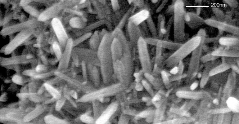

Through a process discovered by researchers at the University of Tokyo, a polymer fills in the tiny gaps and ridges between and within the needle structures of a metal surface, thereby creating a strong bond.Image courtesy of University of Tokyo

The bonding method entails pre-treating the galvanized steel with an acid wash and dipping it in hot water. The acid wash strips the outer passive layer on the zinc coating of the steel, allowing the hot water to form rough nanoscale needle structures on the true surface, explained a press release on the university website. When a polymer is applied to the treated metal in a process called injection-molded direct joining, it fills in the tiny gaps and ridges between and within the needle structures, thereby creating very strong mechanical linkages. "We found that immersion in hot water was a simple and effective method for producing nanoscale structures on the zinc coating for the polymer to adhere to, but that prior acid-washing to remove the passive layer was a necessary step for this to occur," explained the paper’s lead author, Weiyan Chen.
The group also showed how the tensile-shear strength increased with the complexity of the nanoscale structures on the galvanized steel surface. By optimizing the hot water temperature and treatment time to achieve peak complexity in the nanoscale structuring, the team was able to significantly increase the tensile-shear strength compared with untreated metal.
