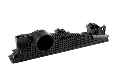

Solvay Performance Polyamides has launched Technyl Red S, a highly heat stabilized polyamide designed especially for automotive applications operating at a continuous temperature of 200°C. It is reportedly an ideal solution for turbo engine air ducts and coolers as well as cylinder head covers.
Technyl Red S offers superior strength after aging. |
Charge air coolers are engine parts that benefit most from the performance attributes of Technyl Red S. |
