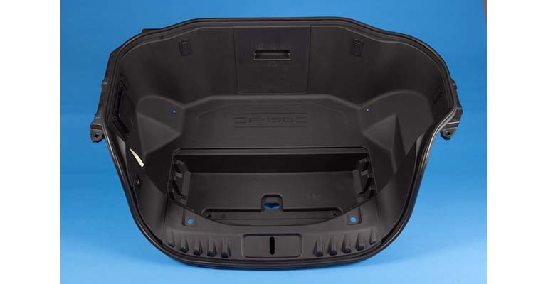

The Ford F-150 Lightning's front trunk — the largest in the industry — won the Body Interior Category and also captured the Grand Award.

Grand Award and Body Interior Category Winner: Mega Bin/Frunk
  • OEM make and model: 2024 Ford Motor Co. Ford F-150 Lightning
  • Tier supplier and processor: Cascade Engineering
  • Material Supplier: Celanese
  • Toolmaker: Commercial Tool Group
  • Material: Celstran PP-GF40 AD3004 polypropylene long-fiber thermoplastic (PP-LFT) with 40% glass reinforcement
  • Process: Injection molding
By converting from compression molded painted sheet molding compound (SMC) to injection molded PP-LFT to produce this large Class A composite front trunk, or frunk, (pictured above) — currently the industry’s largest — mass is reduced 48%, productivity increased owing to a 37% cycle-time reduction, the cost and environmental burden of paint is eliminated, seal interfaces are improved, secondary routering of holes is no longer needed, and the frunk is fully recyclable at end of life. A 4,000-tonne injection press and tool equipped with a 16-drop hot-runner system are used to mold parts.
