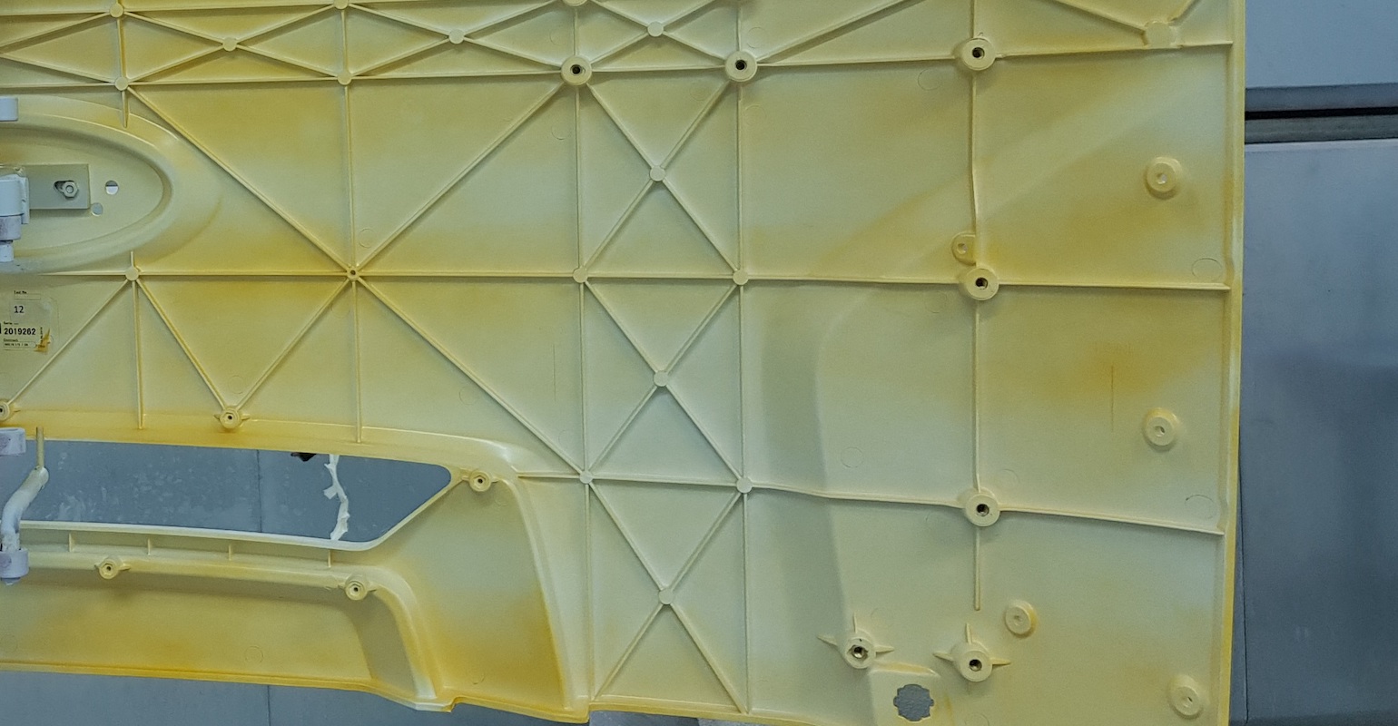

truck panel
Image: Oxford Advanced Surfaces
Oxford Advanced Surfaces (OAS), a pioneer and market leader in the surface preparation of plastic and composite components for painting and lacquering, has developed a new treatment that reduces surface preparation time by more than 90% compared with the existing approach of sanding. Kotefast is available in a water-based formulation, avoiding the need to use solvents in the workplace. The solution can be used with thermoset resins such as polyester, epoxy, polyurethane, vinyl ester, and phenolic, and is equally suitable for treating engineering plastics such as polyamide, polyimide, PC-ABS, and PEEK.
Kotefast was tested on a polyester truck panel (see photo) and the treatment time took less than 15 minutes. An identical panel took three hours to prepare via the usual method of manual sanding, indicating a time saving of more than 90%.
