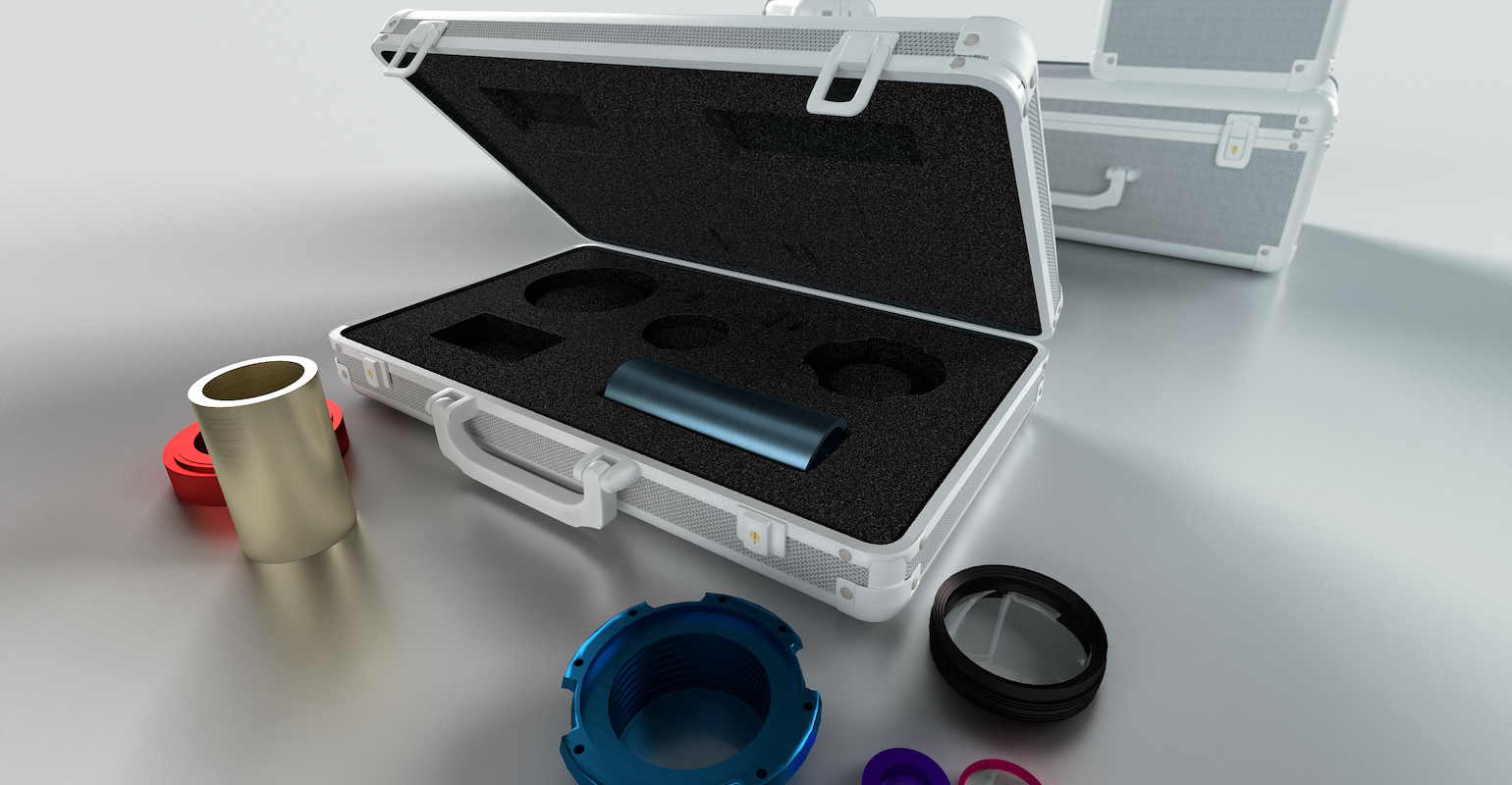

foam from Zotefoams used in lens case
Image courtesy of Zotefoams
