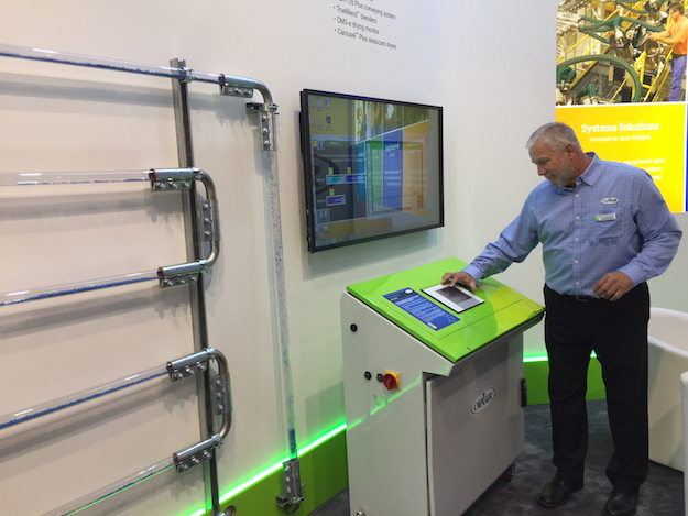

Conair’s Doug Brewster puts the R-PRO conveyor system through its paces using the FLX-128 Plus controller at K 2016.
At the K, Brewster is demonstrating the R-PRO using the new FLX-128 Plus controller, a smarter, faster and more powerful version of the popular FLX-128.
