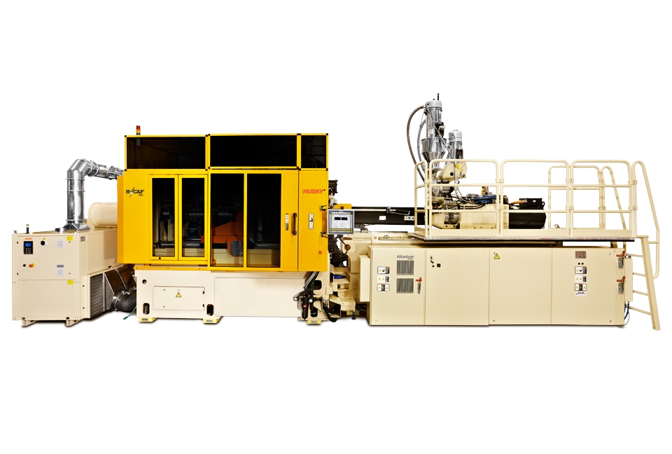

Behind a locked glass enclosure, into which attendees could only gain entrance with a special Husky supplied badge, the supplier operated a HyCAP HPP 300 machine injection molding a 1.2g 29/25 lightweight water closure in a 1.85 second cycle from a 72-cavity KTW mold. Husky acquired KTW, an Austria-based closure moldmaking expert, in 2011.

Walls on either side of the injection molding machine, which was situated so that only the platen end was visible from outside the glass partition, prevented show attendees not given access into the cell from seeing its most distinctive feature, a mold that stayed closed while 72 caps dropped from its lower half onto a conveyor every 1.85 seconds.

Zhang said that in a 72-cavity mold, it's typical to see cycle times of 2.5 to 3 seconds vs. the 1.85 seconds achieved by the HyCAP. The fact that Husky debuted the technology in China is a testament to the local market's explosive growth potential for beverages. Zhang noted that per capita beverage consumption in China is still relatively low compared to developed western markets, saying that the country could double or triple that consumption, despite any broader economic softening in the country. The beverage market has historically expanded at 1.5 to 2 times the growth rate for GDP, according to Zhang.
