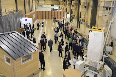

Wood-plastic composite (WPC) profiles are gaining greater acceptance as building materials, and battenfeld-cincinnati (Vienna, Austria) showcased its latest developments in the WPC sector through presentations, exhibits and the demonstration of a WPC line at its technical lab in Austria. A “Simply Housing” model house from TechWood International UK was exhibited and an H-profile, which is used as a connecting element in the house construction, was extruded at the Applied Market Information Ltd.’s WPC conference in Vienna, Austria.

The complete line was demonstrated in cooperation with system partners for tooling (Beologic, Belgium), material conveyance (EMDE, Germany) and the gravimetric dosing system (ConPro, Germany). The 160 x 30 mm H profile that was manufactured at the event is made from a compound consisting of 72% wood fibers and 28% polypropylene (PP) with additives, said battenfeld-cincinnati’s information.
