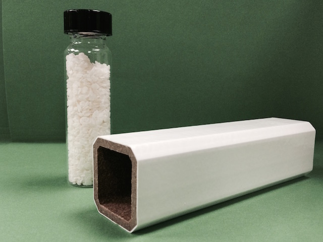

Metabolix is testing a PVC/WPC (wood-plastic composite) material for decking and railing applications. Working with Integrity Composites LLC, and its compounder Otech Corp., Metabolix has helped the companies formulate a WPC that contains both PVC and wood flour, at a very low loading level of PHA. "With the PHA additive, we found that we can use less PVC and more wood flour, which results in a strong railing with a cost benefit to the formulation," Brum noted. Launch of this product by Integrity is currently underway.
