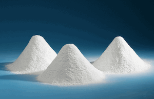

Glass bubbles are functional fillers that can reduce density, accelerate cycle times, and eliminate notable warping in plastic parts.
3M Glass Bubbles are finely dispersed, free-flowing powders consisting of thin-walled (0.5–1.5 µm) spherical soda lime borosilicate glass particles with an average diameter of 16–65 µm. “First innovations which are now in production, such as scuff plates in vehicles, show great potential for further light-weight applications,” says Heinrich Lingnau, Vice President and General Manager EMEA at A. Schulman. “Due to the combination of 3M’s hollow glass beads and our innovative filler systems, a weight reduction of 15 percent can be achieved without compromising on product properties.”
