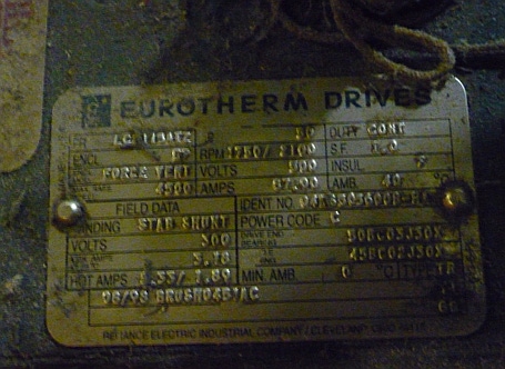

The motor nameplate provides the information you will need to calculate your top screw speed.

Look at the motor nameplate (see photo). If it’s a DC motor, you will see maximum voltage. It may not say “max,” but it’s usually 500 V for middle-large lines, maybe less for smaller ones. You now can tell the voltage actually used, as it is in proportion to the speed. For example, if actual screw speed is 60 rpm and max is 120, then the voltage is 250 V, and the available power (volts x amps) is half what it is at max voltage. That protects the system against excess torque, which can twist or break shafts—that happens when too much power is delivered at low speeds.
With the AC motors that have been preferred for the last 20 to 25 years, the principles are the same but the calculations aren’t as simple. There are several different types, so talk with the motor maker, if needed, to learn how to calculate torque and actual power in use.
If you look at the max screw speed on the nameplate, you’ll see a number usually around 1750 rpm. That’s the max motor speed, so divide that by the max screw speed and you have the reduction ratio. If you see two numbers—1750/2100, for example—it’s a field-weakening DC motor, which may be able to get higher screw speeds but no more than rated power; that is useful if you are already at top speed but not drawing full power. And if you are running close to or at max amps (also visible on the motor nameplate) you may want to reduce top speed with pulleys or some other means, so that top speed is less but more power is available at any one speed.
