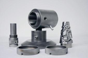

guill-tool-bullet-2The Bullet II allows quick tooling changes, as the tips remove from the back and the die removes from the front of the unit, explains Guill Tool. The absence of fastening hardware eliminates leaking, as does the taper body and deflector design pioneered by the company. The new patent pending Cam Lock deflector retaining system requires only a half-turn to remove and install the deflector and tip without the use of any hardware. The technology simplifies cleaning and reduces downtime, notes Guill Tool.
