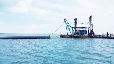

Resin supplier SCG Chemicals has partnered up with Thailand’s Provincial Waterworks Authority (PWA) in the country’s first-ever underwater pipeline installation project, featuring a freshwater water pipeline of approximately 20 kilometers from Khanom District in Nakhon Si Thammarat to the island of Samui in Surat Thani. The subsea pipes are made with what SCG Chemicals describes as the world’s first PE112, a high-density polyethylene (HDPE) resin developed by SCG that affords 10% greater pressure resistance in comparison to PE100 grades available on the market. The material helps ensure that the pipes meet required safety standards and achieve maximum efficiency.
PE112 resin performs in a major undersea water supply pipeline in Thailand. |
