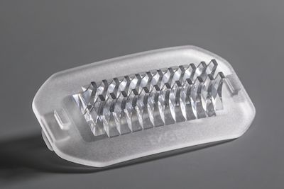

With their filigree structure, LED lenses place extremely high demands on the injection molding process. The trend is towards LSR lenses. (Picture: Engel)

As with the established thermoplastic lens materials PMMA and polycarbonate, silicone offers significant weight savings compared to glass. However, LSR is reportedly superior to these organic polymers in terms of thermal and chemical resistance. Highly transparent grades for optical applications have a lower yellowing index than thermoplastic lens materials. They are extremely resistant to environmental influences such as UV radiation and can be used over a wide temperature range from -40 to +200°C. In addition, they allow particularly flexible design. In terms of the geometry, there are almost no limits when injection molding LSR.
During Chinaplas in Guangzhou this May, Engel will be processing Dowsil MS-1002 Moldable Silicone by Dow Silicones, a material developed specifically for use on injection molding machines. The curing speed has been optimized to obtain a smooth and very hard surface similar to thermoplastic. The high light transmission ensures a very good luminous efficiency. In addition, the high thermal stability enables an outstanding transparency. The surface, with its extremely filigree structure, is molded with highest reproducibility. The LED lenses leaving the production cell are ready for installation.
