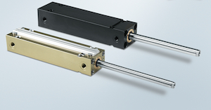

Hydraulic cylinders in a range of stroke lengths are now available from stock by Meusburger (Wolfurt, Austria). Because of the countless variants on the market, the selection and configuration of an appropriate hydraulic cylinder is time-consuming and difficult. E 7000, E 7001 and E 7002 hydraulic cylinders from Meusburger are now available from stock in stroke lengths up to 200 mm.
A specific characteristic of the double-acting hydraulic cylinders are the standard axial and transverse holes. The hardened and ground piston rods offer optimal protection against damages and leaks. All Meusburger hydraulic cylinders are equipped with FKM (Viton) seals, enabling operating temperatures of up to 180° C. Also, matching accessories such as couplers and magnetic proximity sensors for position monitoring are available for download immediately: Stroke parameters are directly entered in the digital catalog and then transferred to the appropriate CAD program.
