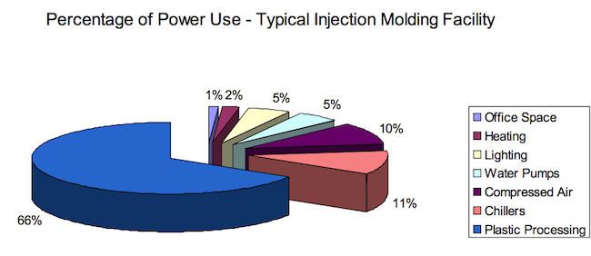

Of the total energy consumed by injection molding machines, it is estimated that barrel heating constitutes 15 to 40%, with injection molding facilities requiring 0.9 to 1.6 kWh/kg to process plastics. “The actual value depends on many factors including processing efficiency,” said Blau, “but the real message is that no energy plan is complete without a strong focus on machine energy and barrel heating.”
