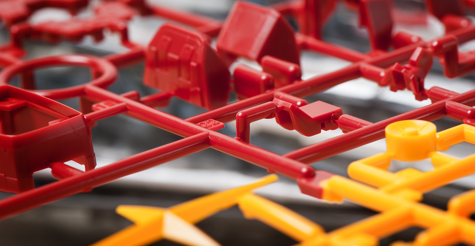

injection mold sprues
Norasit Kaewsai/iStock via Getty Images
