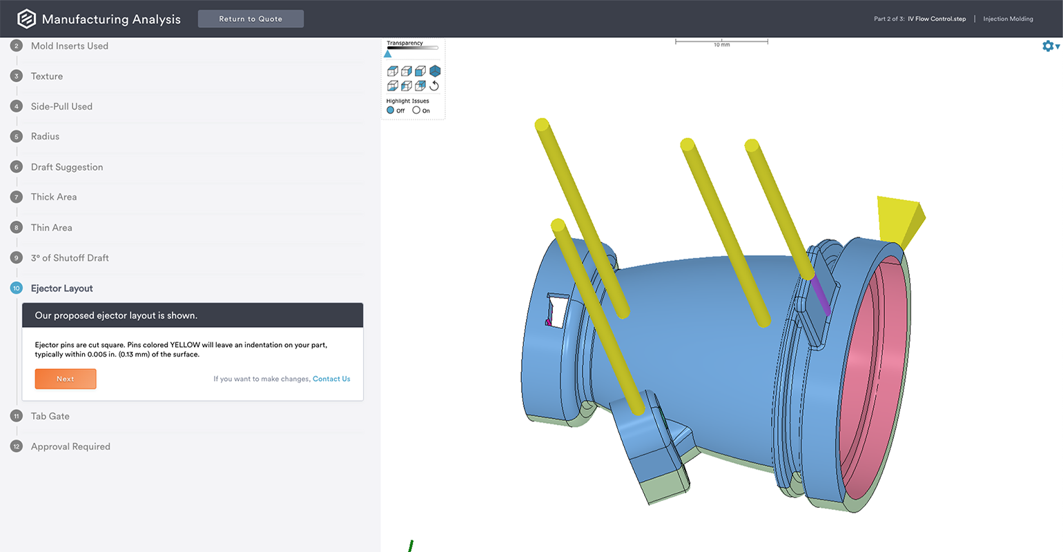

Molds require an orifice (gate) to push resin into the cavity and ejector pins to push the part off the mold. Standard single-cavity and rapid turn-time injection molding will default to the tab gate. It’s simple, effective, and doesn’t require special hardware to make it happen. Consumers are used to seeing high-volume production parts with hidden or camouflaged gating, but you can hide them with specialty gating, although it can be expensive and add time. A tab gate doesn’t require time, it just needs to be cut at the parting line and — boom! — you can start molding parts.
Ejector pins are required, but you can hide their imprints. Generally, the non-show side is inside the assembly. But you may struggle if you are making, say, a soap dish where the inside is the show side. Remember, as the part cools, it shrinks onto the mold. Molders will place “internal features” onto the ejector half of the mold even it is a show surface. Getting your molder involved early may help offer solutions to make sure your cosmetics stay pretty.
